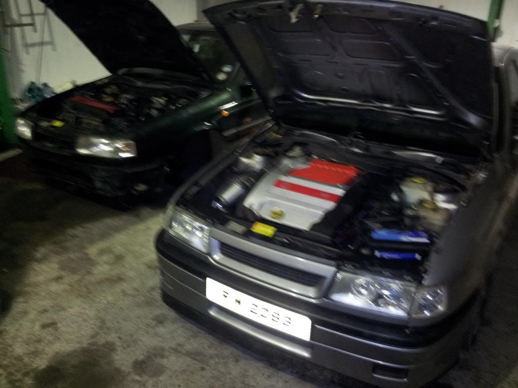

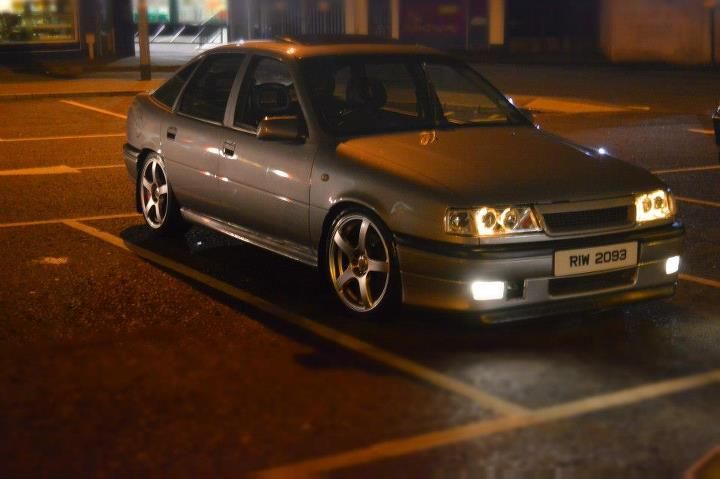

as some of you know this story starts a few months previous and this gls cavalier was never ment to be part of the project. to follow the build from the start you might want to have a quick look at this thread it may explain a few things.....http://www.migweb.co.uk/forums/proj...rations/512942-my-cavalier-sri-powered-c20xev-saab-b204l-c25xe.html#post4690705
this silver cavalier was bought as a daily as my daily mg zr sh*t itself,i didnt intend on buying a fuel guzzling v6 as a daily but my mate encouraged me to go have a look at the cavalier and once i got there and heard it run i knew it was going home with me, ÂŁ850 later and heres how the cavalier looked when i got it to my garage.
9 dec 2012
exterior and engine
2.5 v6 conversion c25xe (origoanlly a 2l)
5 stud turbo brakes and hubs
lowered
angel eye headlights
17 inch alloys (were a definate to be removed)
m3 style mirrors (also a defiante to go)
gsi front bumper
seat front splitter
turbo/gsi front grille
astra mk4 side repeaters
interior
leather seats, heated fronts
calibra turbo steering wheel
gls door cards
sun visors with lights inside(gls standard i believe)
tinted rear windows

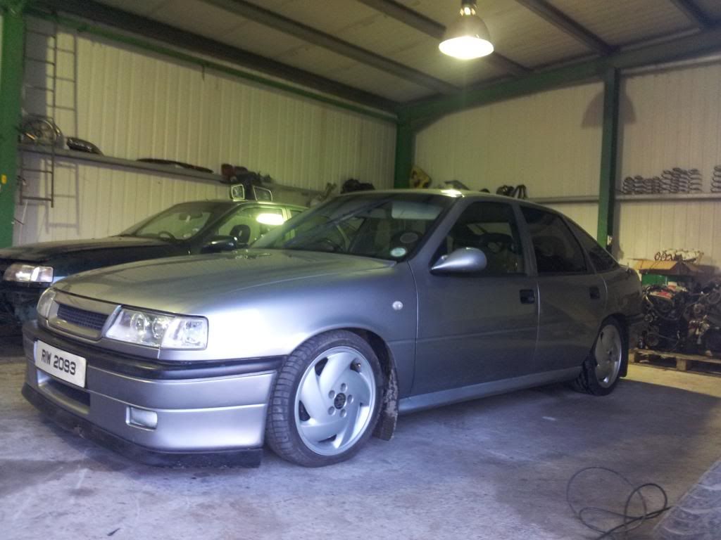

the car was pretty clean and was said to have been resprayed two years ago

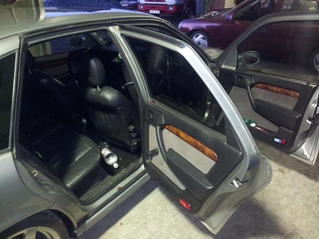

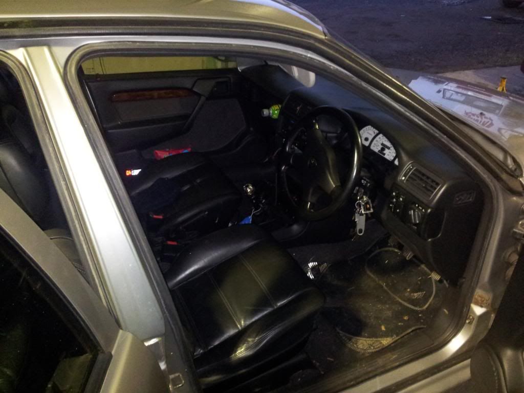

so i got to work messing around in the garage, thought i would try on my mates turbo rims,then i ran into a minor problem, locking wheel nuts with no key to remove them, after a little head ache i relised i could use a 1/2" extension bar and hammer it into the locking wheel nut and with a 1/2" drive breaker bar they loosened with no problems.
brute force solves everything
then i got the turbo rims on and absolutly loved them so they were added to my "wish list"

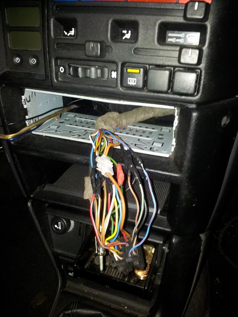

a previous plonker who owned teh car also decided to chop the cd player wiring and connect every wire up the wrong way for watever reason and i mean every single wire so i sorted it and put every wire together acording to colour, no wonder the cd player didnt work, bloody idiot how hard is it to connect wires together matching the colours
then i done a little searching around my garage and found a few things that could tidy the car up a bit, went out and bought some gm mudflaps(which i still have never fitted)
my interior mirror covers were sprayed silver(racey) so i replaced them with some origonal black ones
i also had a big maxpower light up racey gear knob, i replaced that with a bog standard nova 4 speed knob, trust me even that was better looking for now
after a day messing around and tiding bits and pieces i took it for a good wash
than my mate came out with his very expensive camera and got some excellent photos :)

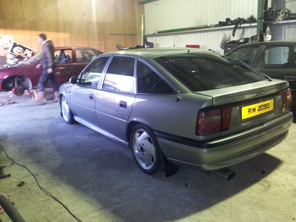

after the new year was over things started to get more serious and the daily was getting more attention than the sri saab turbo project, i decided i was going to gsi the whole exterior to fit in with the front bumper so i went and bought a full gsi kit.

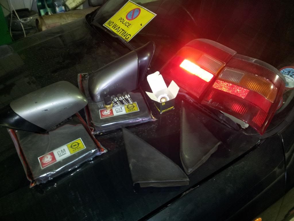

the rear bumper will need alot of modification but i willing to give it a go.
heres a pic of the bits il be needing, i got a bumper spoiler and grille aswel but il not be needing that so il set it aside as spare of maybe sell it some day

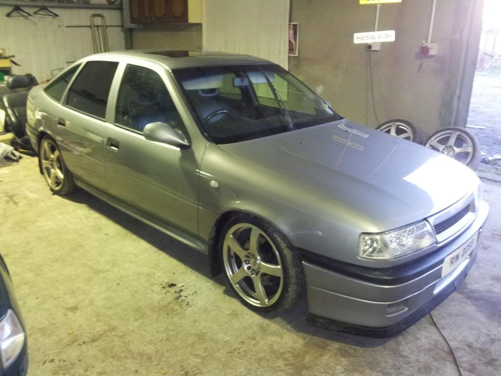

the following week i finally found myself a set of turbo alloys, i had been searching for weeks and a set popped up for sale just down the road, i snapped them up quick, not bad at ÂŁ200, they came with only three genuine centre caps but some idiot had stuck opel badges over the top of the vauxhall sticker so they looked idiotic to say the least, il be getting new stickers from somewere and im going to source another centre cap aswel
straight onto the car they went

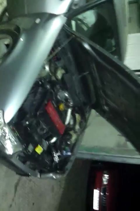

below is a picture under the bonnet, you can see the thin black wire(thats the ignition live coming off the cavalier interior loom), wire that straight to pin 60 on the saab ecu and that will give power to your ecu
