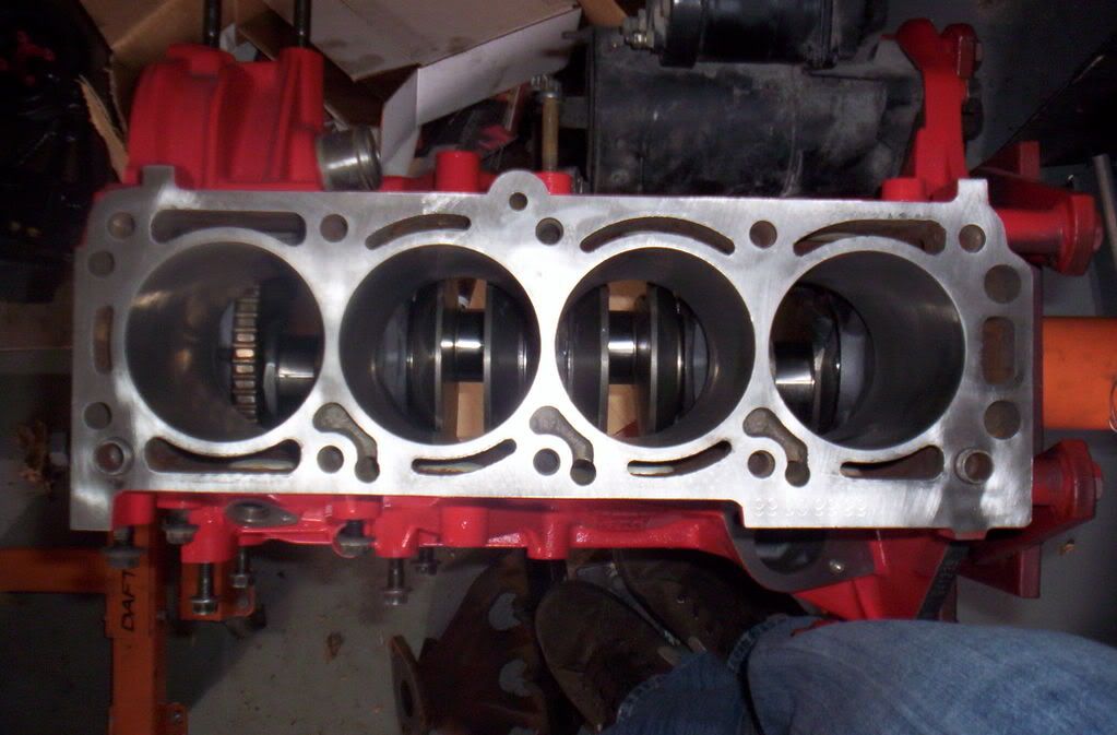

the first is MY block which was a C20NE block without the valve fitted
the second is the same block, different pistons but this time i had the little bung fitted, notice though that this doesnt work as there is not enough block surface area around the outer edge to seal against the head gasket, so without adding more surface face (welding the block and having it surfaced again) you cant really run a 16V head on an 8V block with a 16V gasket..
