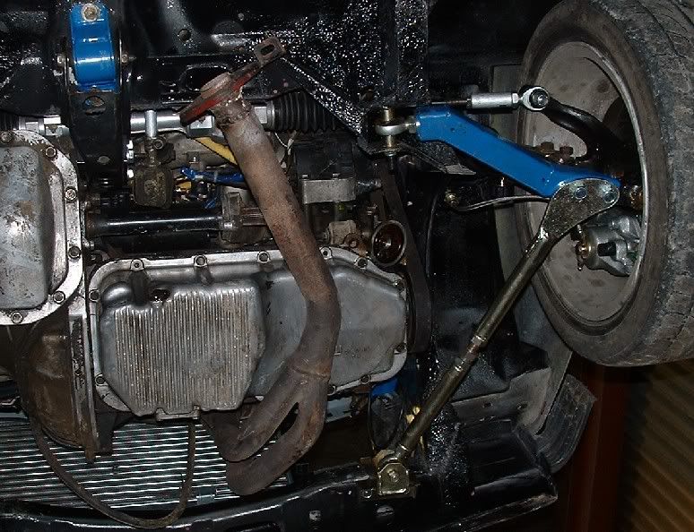

As per the pic below, I want to rose joint my Nova's lower arms.
Question is, where can source suitable rose joints? Have found them readily available, but am after something that can withstand the daily pounding. What 'tolorances' do I need to look for?
Any ideas?

Aurora rod ends used to advertise in Car & Car conversions. try searching for them.
Ive got the TAS rosejointed TCA's on my Nova. Wicked mod tbh.

bear in mind you'll want to make up some nice spacers with decent shoulders on them to take up the space left by the original width of the lower arm, oh and try racecar.co.uk forums for rose joints:beer:
4,050 Posts
Yeah, that's the TAS kit above. That's a pic of the underside of my Nova.
What are the tie-rods in that pic
That's a close up pic of what the tierod/trackrod end looks like. Just an extension bar and a rosejoint to replace the original version.
