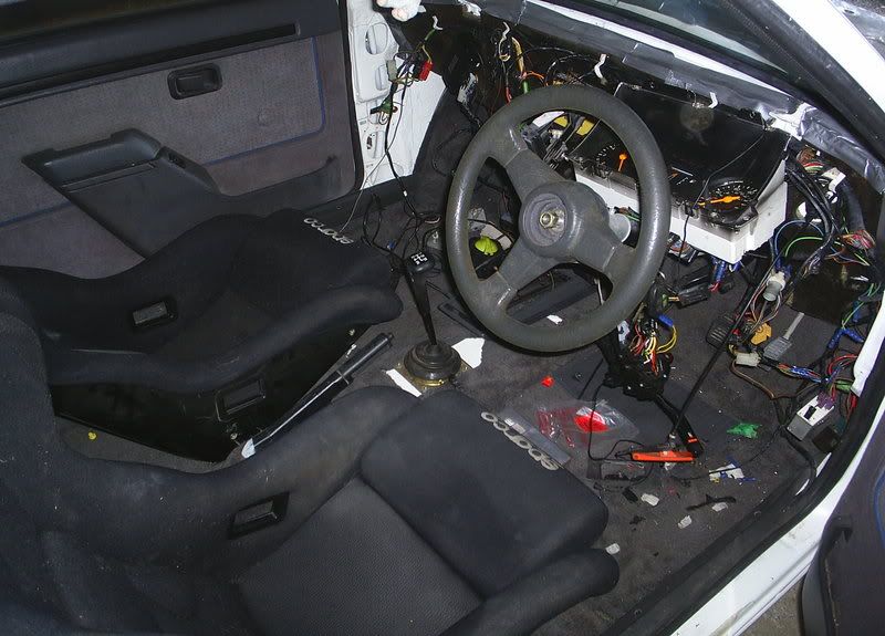

thats another 12 hour day at the s1 ,made a lot of progress with the wiring loom which was in a bad way ,still got the headlight wires to sort but i can do that in place ,
put most of the inside stuff back in ,and i know the sound deading is not original and its stuck down with gaffa tape ,but i am not going for a concours car just a really good s1 i can use all the time and take to a few show and shines :D
i think over the years this car has had a few resto attempts and the count less spray jobs had taken its toll on all the parts with over spray on every thing and it takes me ages to scrub and clean all the part ,took me 3 hours on the fuse box alone and i am still not that happy with it ,but we will see ,might try and source a good second hand loom ..........
heres some of todays pics
been busy again today ,decided i would tackle the wiring in the engine bay :cry: :cry: :cry: what a nightmare the whole loom was covered in overspray from a past respray

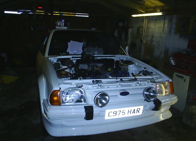

been a while since i updated anything thats cause ................i hav done fook all to it lol ,every since i bought the car i knew the turbo was on the way out and it was gonna be have to be replaced so i was always on the look out for one
but when this engine turned up local to me i had to have it ,its in near new condition with less than 9,000 miles on it bought from ford a few years back ,since then its had high lift cam fitted ,V-pully and a brand new stage 3 turbo fitting
and i managed to get the whole lot for £500 :top: :top: so its out with the old and in with the new :top:
also bought a chipped ecu so once its all fired together it will be interesting to see what it will make

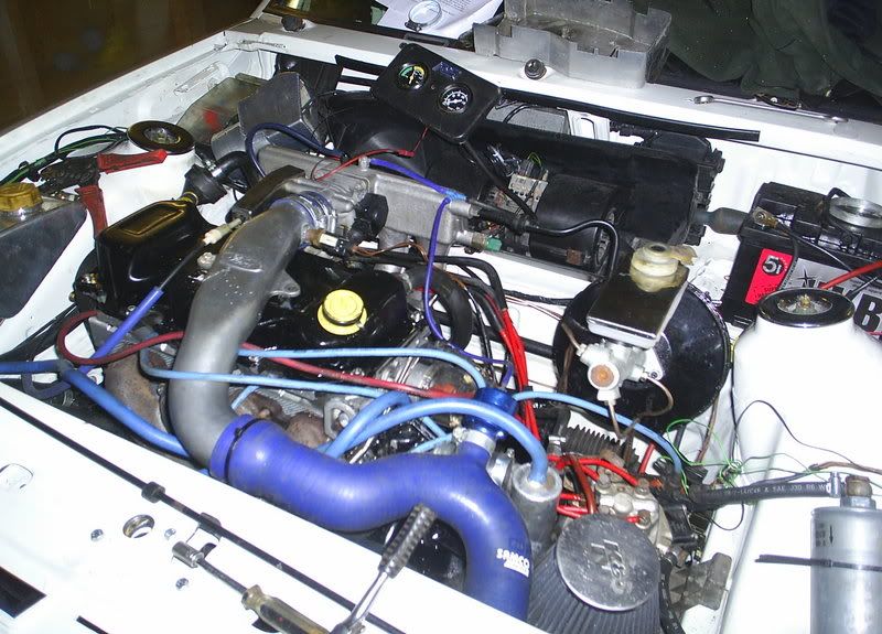

after a lot of hassle and a lot of work i finally got it to start ,over the last few months i have been workin on the car checkin and double check things still with no luck ,if i where honest i very near threw the towel in :cry:
but with help with peeps of here and other sites i cracked it :banana: :banana: :banana: :banana: THE S1 LIVES AGAIN ,once i got the electric problem sorted and then the twatting metering head that would,nt let the fuel out ,it near enough started first time :banana: :banana: then just ticked over ....fook it sounded good after a year of silence :thumbsup:
with the job sheet getting shorter and shorter i feel its come a long way in the 13 months since i started
still have a lot of probs to iron out and need a good clean up but nothing that cant be done before next summer ...............come on the shows :banana:
looks a bit untidy still under the bonnet ,think i need more ch:thumbsup: rome
