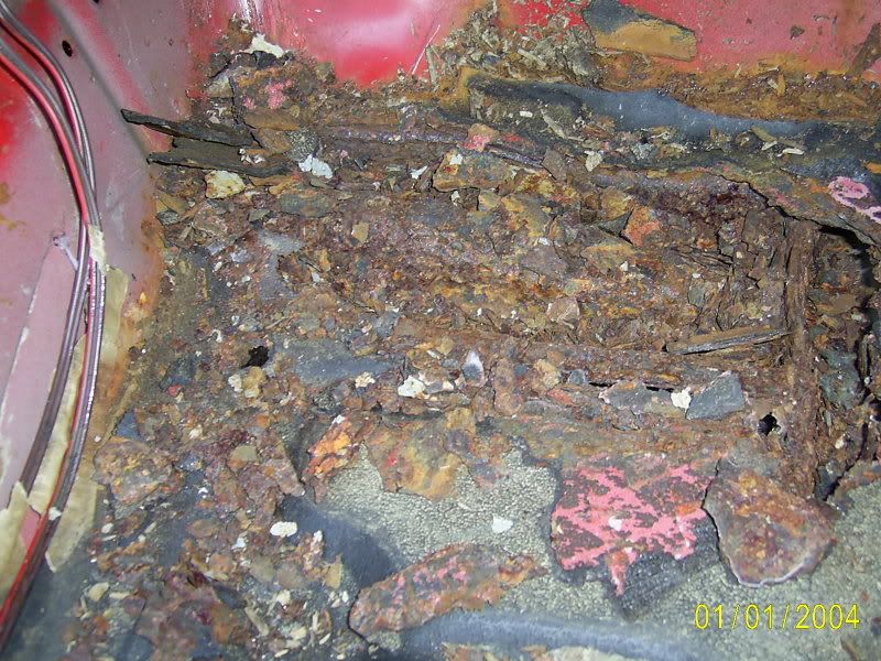

    In this picture below you can see some water in the rubber bung when I uncovered the bitumen layer!!
    if it wasn't for the earth , there wouldn't be any universe, mother earth gave birth to all the creation! and without the earths gravitational pull, the sun and the moon would have long gone adrift!

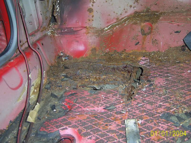

    Out with a grinder, I have cut out all the rusty rotten steel, grinded off the stubborn rust that the wire brush wouldn't touch, looking forward to do my first ever mig weld tomorrow, when the thing comes over, going to go out no0w to get some steel plates 1.5mm galvanised and some 2 mm for repairing the jacking point and chassis runners. Probably end up making it even stronger than original strength. Won't be making any short cuts now, my nose filter got blocked with so much rusty dust, should have worn face mask.
