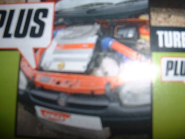

Old 31-08-2005, 17:08   #247
Join Date: Jul 2001
Location: Oldham, Lancs
Drives: 3.0V6 Corsa With NOS
iTrader: (7)
Posts: 1,708
BeArDy is offline   Reply With Quote
Old 31-08-2005, 17:56   #248
MIGWeb Moderator
jamied's Avatar
Join Date: May 2003
Location: northampton
Drives: GTE 3lt V6 TwinTurbo
iTrader: (14)
Posts: 5,752
good pic...

nice and detailed

Old 01-09-2005, 14:01   #250
Join Date: Jul 2001
iTrader: (7)
Posts: 1,708
its only small PMSL
its in the back of totalvaux and has a full feature next month
talking to a bloke who knows the owner says its cost him Ј6000 to have a company fit the engine and turbo it and set it all up, supose to be a nightmare of a job......
