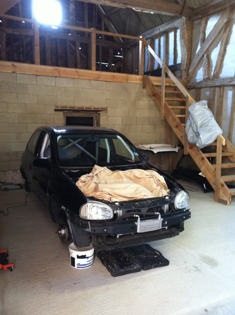

    only a little update, got the car over to my new workshop/barn yesterday so went down this morning and did a few bits, first on the list were the front disks and green stuff pads, i then set about removing the brake master cylinder and pedal assembly as i have been on a bit of a spree lately lol and have a harry hockley bias pedal box on its way to me..along with a fair few other bits anyway heres a few pics...
    her new home
    old disks
    new disks
    new pads
    removed old setup..
    how i left her...
    as you can see it needs a good ol' scrub and prob a lick of paint around scuttle area..will do this next weekend as need to cut the lip of metal round the firewall off a bit more in order to run new brake lines safely withy the 90mm trumpets im running.
    now i have the workshop i can crack right on with it so am well chuffed right now
