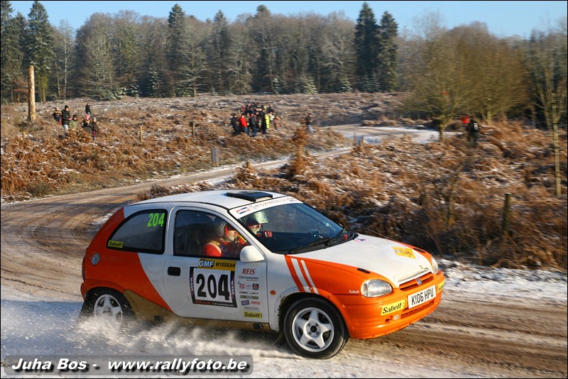

    Been a while for various reasons but the cars just completed it's first event.
    Pics of the car:
    and one for the sponsor...
    I can suppy Sabelt products at the best price you will find. Direct from Sabelt.co.uk.
  20. #94
    Nov 2009
    North Yorkshire
    70
    Re: Corsa Rally Car
    We're doing the BTRDA Gravel Championship again and the first event was the Wydean Forest Rally last week.
    Unusualy we were loaded up and away in good time and got to scruiteneering when it opened.
    Unfortunately we lost 4th gear going from noise check and had to take out the cluster. It turned out that a peice of the 3rd gear baulk ring had broken off and wedged into 4th gear baulk ring. We found the peice and could get all the gears.
    The stages were sheet ice and snow and after speaking to Pirelli we ended up using a snow road tyre.
    We weren't looking forward to the event at the start with the combination of the weather conditions, nursing a gearbox and not having driven the car much.
    However, Dave soon got to grips with the car and the tyres worked really well. We did suffer a puncture though but that was a result of the soft sidewall tyres and a rock we hit. We also had a couple of spins where the engine stalled and was then difficult to start and some massive moments with a couple of tank slappers in 5th gear on the ice.
    Other than the initial gearbox problems the car was great.
    Despite the conditions and new car we did amazingly well. We finished 2nd in class behind Julian Wilkes and an unbelievable 7th overall!
    Next event is the Malcolm Wilson rally at the start of March.
    This is how it ended for us last time:
    Got a few jobs to do before then, including sorting out the gearbox.

    wow all i can say is wow ! im doin n xe corsa project but id love to have the time money tools to do this awsome !!!

    Looks awesome mate well done..

    great pics

    Cracking result on the Wyedean, Mr Wilkes can drive the ass off that Nova, keep the updates coming.

    car has come out looking brilliant! well done
    excellent result on the wyedean too, seen some pics of the event and figured the white and orange one must be this car.
    keep us updated with the rest of the seasons performances please!!
