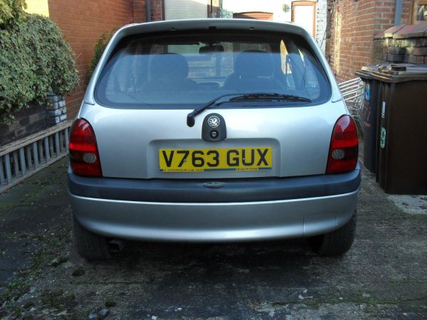

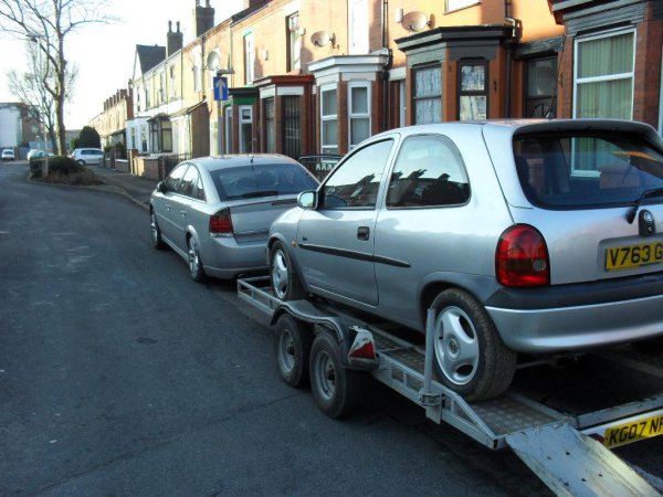

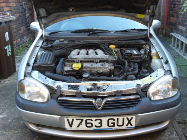

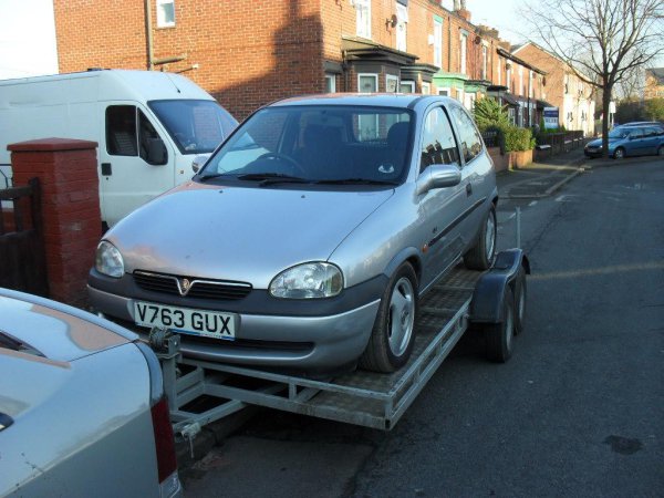

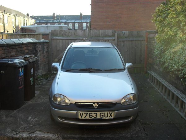

    well let try agen to make a c20let corsa :thumbs: will get pics up of the old one soon

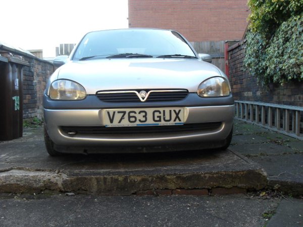

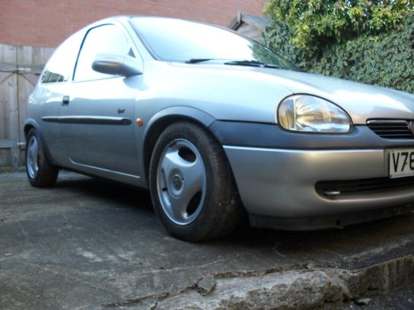

    well the new corsa is a
    1598 cc 1.6 16v sport [ for now ]
    I picked it up cheap on the 22.1.2011
    7 former keepers
    date of first registration on the 12.1.2000
    only payed £240
    will the star picing it up thanks holmegsi for picing it up
    here sum pics of it for now
    out side
    inside

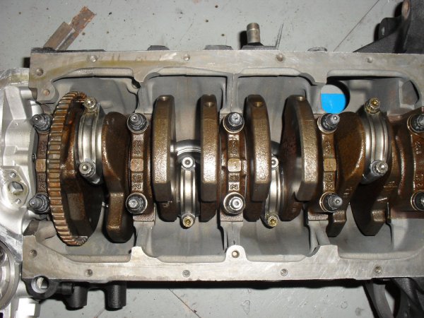

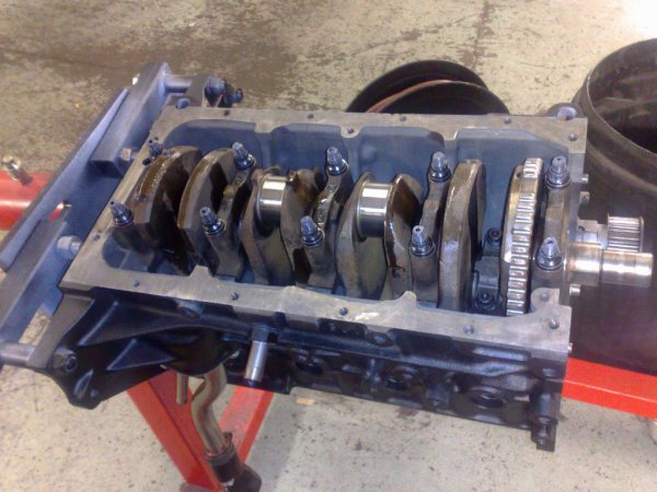

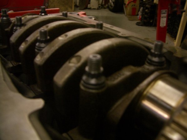

    rebillding my c20let that i got off daz1985
    then pulled it to bits
    then when it was all stripped down i took the block and sump to be acid dipped
    the block has had oil jets fitted bord to 86.5 mm

    THE SPEC
    .ENGINE.
    c20let
    block top refaced
    painted black
    Overbore 86.5mm
    ported, polished, Skimmed coscast / Headwork by philip2
    piper double valve springs
    Bronze Valve Guides
    xe cams
    t3 turbo
    zlet pick up and pump from steveboyslim
    oil jets fitted by steveboyslim
    billet pot type flywheel
    h section rods from steveboyslim
    2mm cometic head gaskett
    kent verniers
    regal top hat
    arp fly, head, maens, rods,
    tx autosport water bar
    tx autosport dipstick breather
    tx autosport magnetic sump plug
    cool running thermostat
    single-v bottom
    baileys header tank
    13 row mocal cooler
    FPR blanking plate
    tx autosport alloy radiator
    Walbro fuel pump
    tial 44m v band external wastegate
    Wideband innovate wideband lc-1
    3 inch exhaust
    .BODY.
    to be resprayed
    Chassis strengthening kit,
    .SUSPENSION.
    spax rsx fronts
    300lb front springs
    avo rear
    lowered tiebars
    whiteline rear arb
    eccentric top mounts
    full car polybushes kit
    equal length driveshafts
    steel rear strut brace from Team Griffinsport
    gsi 22mm front anti roll bar
    Chassis strengthening kit welded on from Team Griffinsport
    Front tie bar lowering plates
    Battery relocated to boot
    .BRAKES.
    goodridge braided hoses
    .WHEELS AND TYRES.
    .INTERIOR.

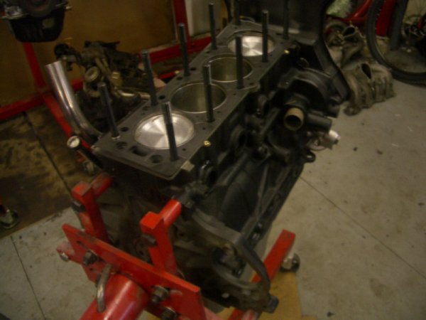

    c20let up date
    oil jets fitted by steboyslim

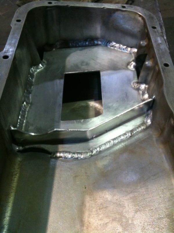

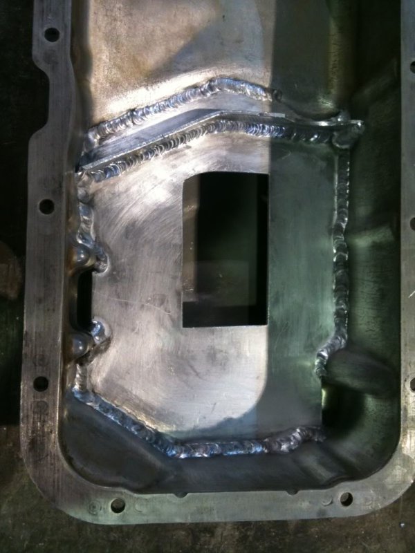

    little up date sent my sump off to be moded with rowlands
    had them dun by dewismortorsport off mig
    thanks dewismortorsport top job and thanks pal

    That is some good piece of work, looking good mate

    i agree with benn, nice engine spec. qick question tho, does the sump have vertical baffles underneth the horizontal pice?

    Looking good - some nice work and a good spec - the tyre and blocks engine stand has got to be a winner too. lmao
