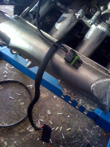

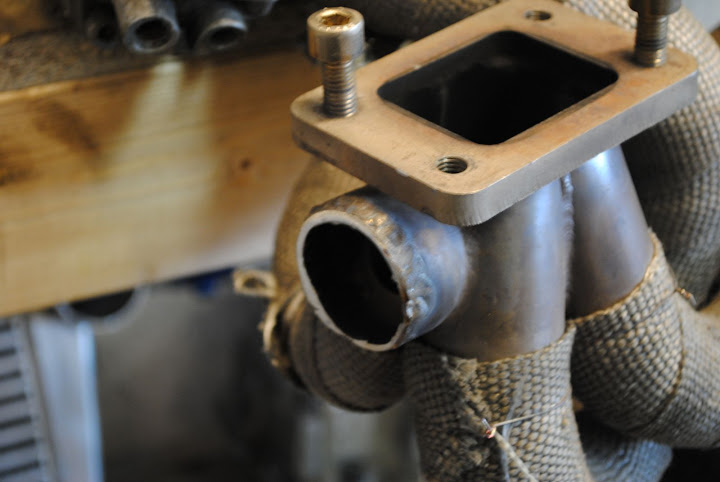

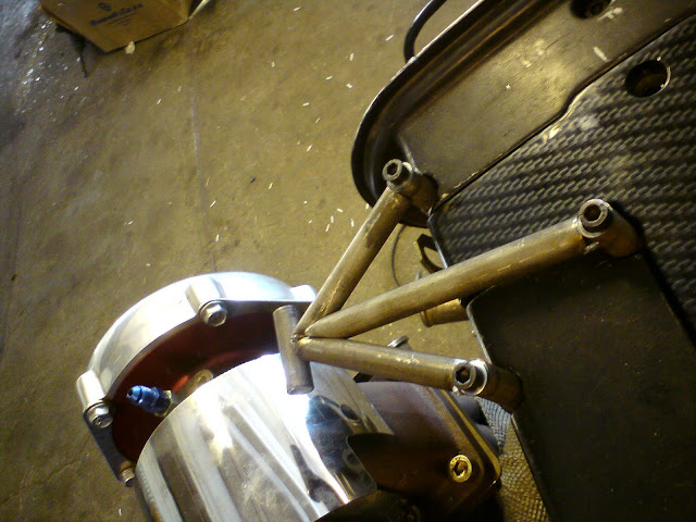

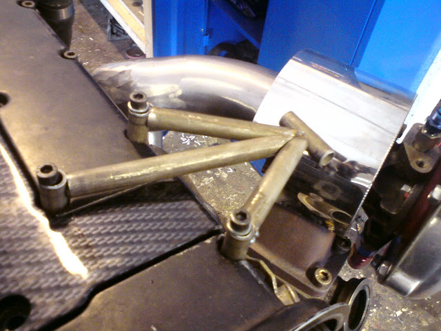

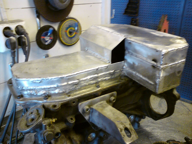

    I started to make a turbo damper in stainless steel.
    Preliminary it`s the only set with welding points to test the angle, tomorrow I will TIG weld it.
    From the small pipe that runs across, I have 2 rod ends that goes down from the pipe to the flange on the manifold, pictures coming soon

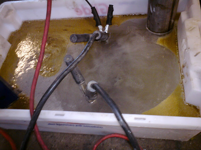

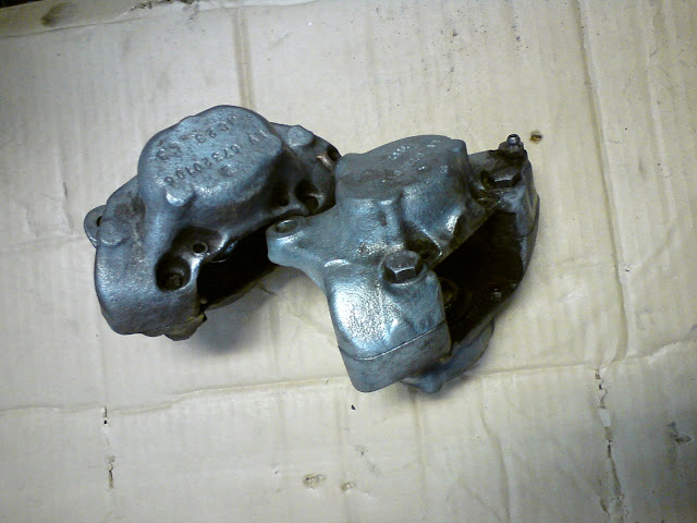

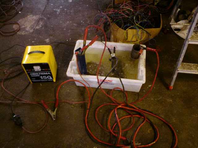

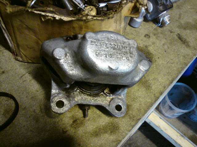

    I've tried to create an electrolytic bath. Found a recipe on the internet, and it was very successful, I think.
    A plastic tube, 20 liters of water, a little sodium hydroxide, a battery charger and a "victim"
    which absorbs the rust and crap from the parts that should be fine.
    The negative pole of the parts, and the plus pole of the victim
    10 minuts after startup
    2 houers after startup
    And the calipers after 24 houers
    Tha calipers was used, and has been on the car for over a year, and was rusty and dirty.

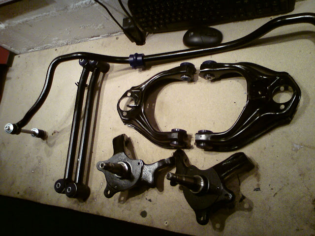

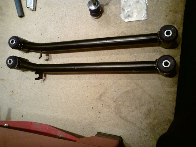

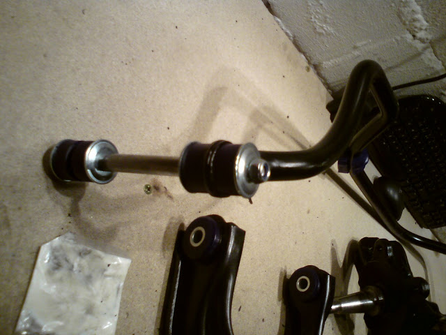

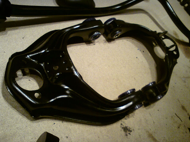

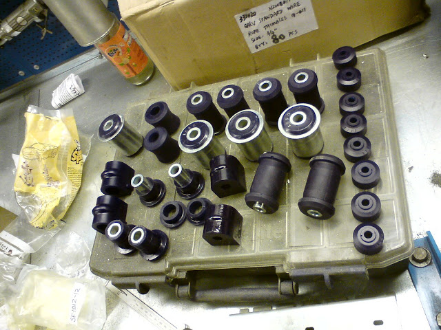

    Bought new super flex bushings for both front axle and rear axle.

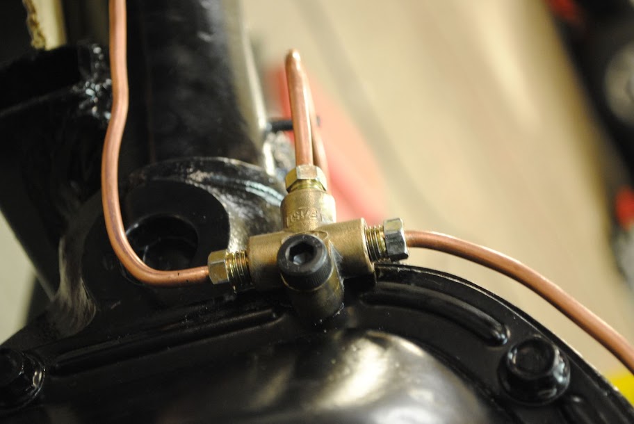

    Made new contacts to oil pressure, oil temperature, and water temperature

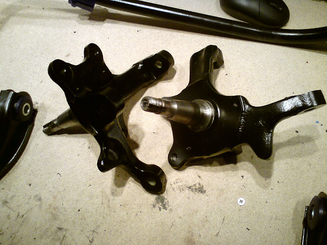

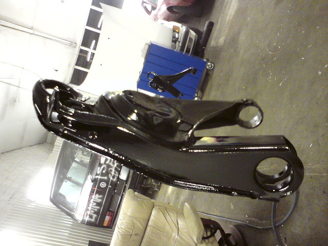

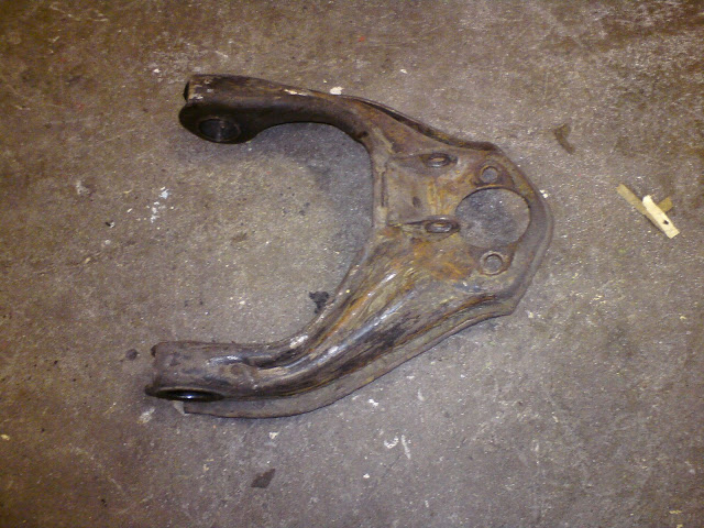

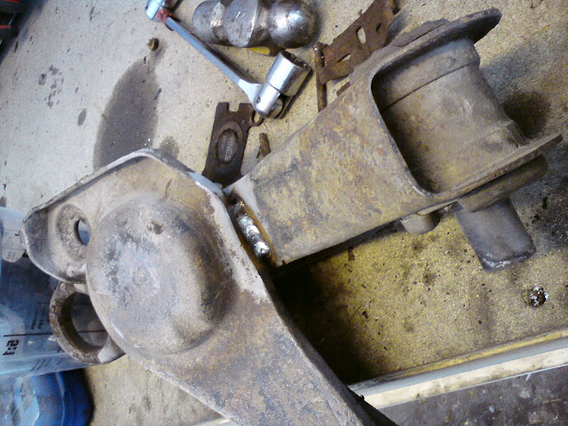

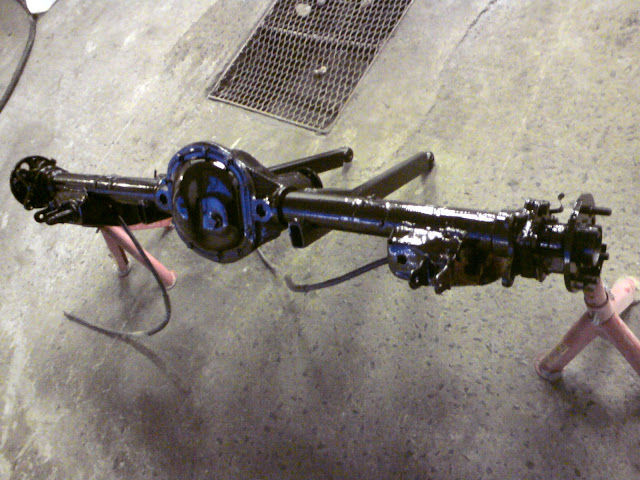

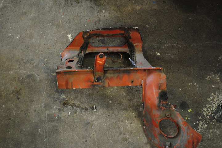

    Scraped the front axel parts for tectyl and paint before sandblasting
    My home made sandblasting machine

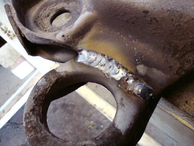

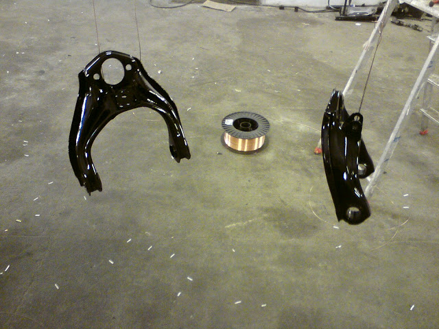

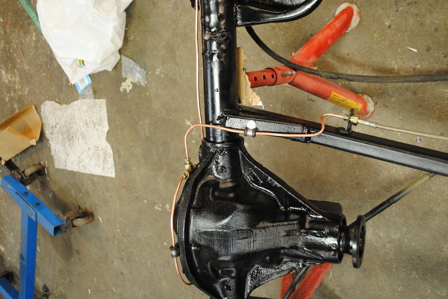

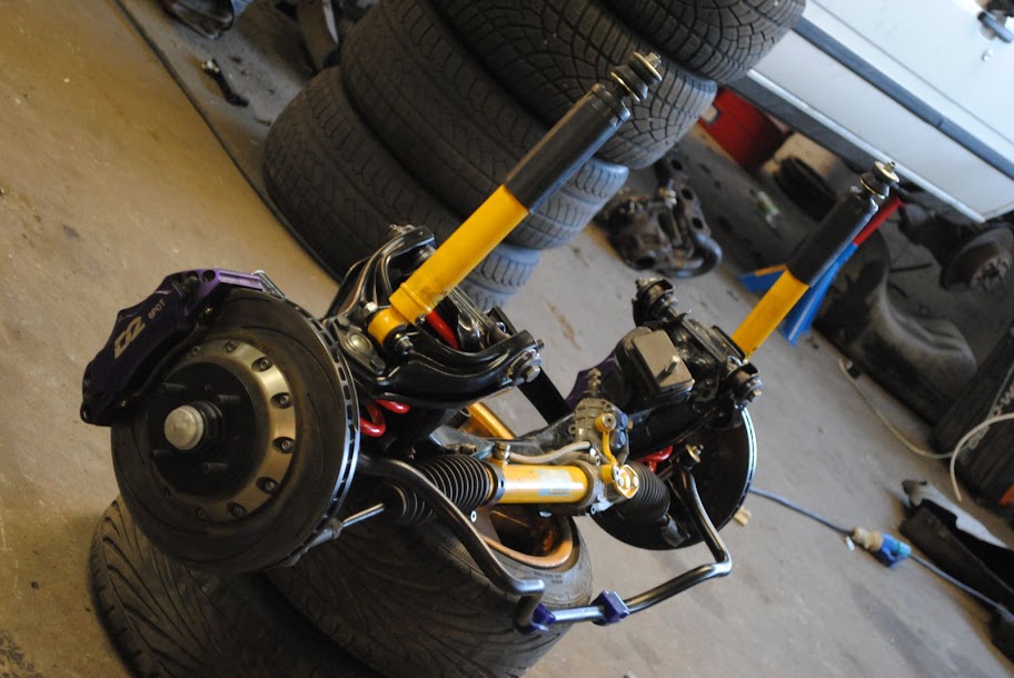

    welding of the front axle
    The parts are finished blast and painted black matte with 2k paint
    (The parts look shiny on the pictures, because the paint has not dried yet )

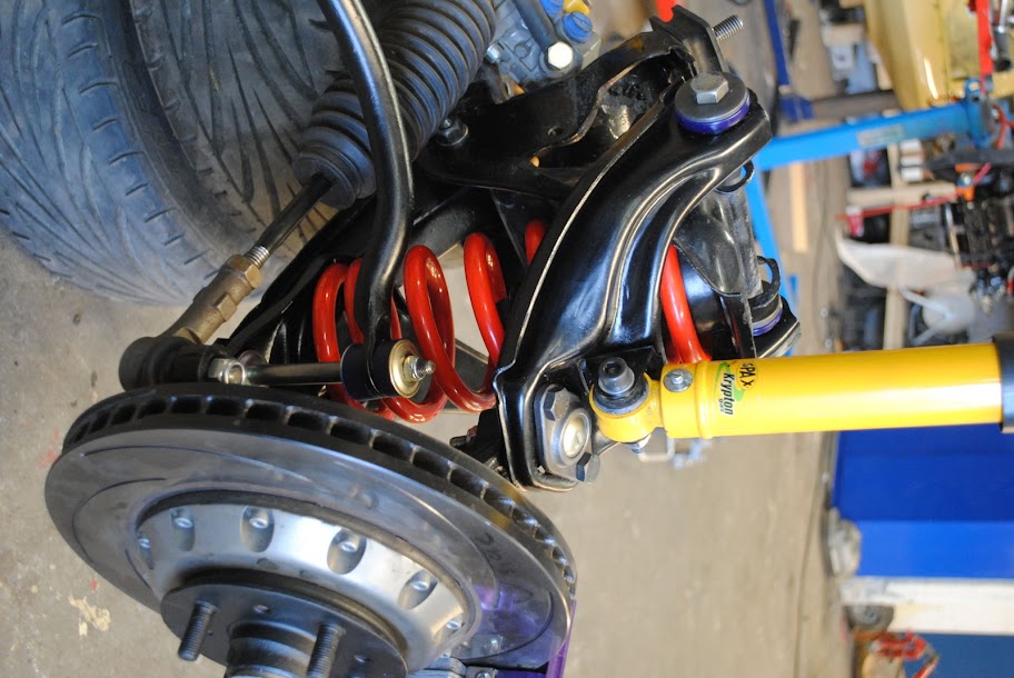

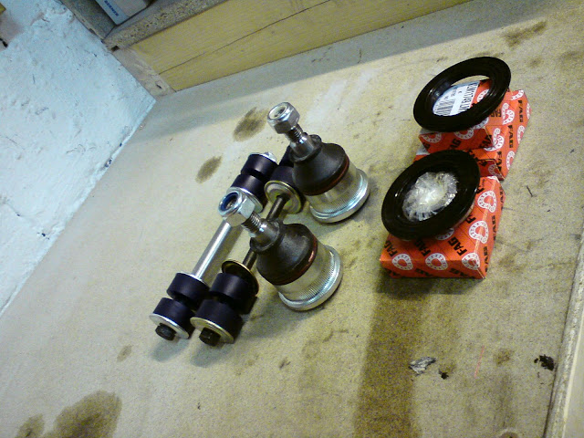

    And some new part to the front axel

    Here is some pictures from today`s work
    The last peaces of the front axel painted today
    Kadett C Turbo - 402whp And 553Nm

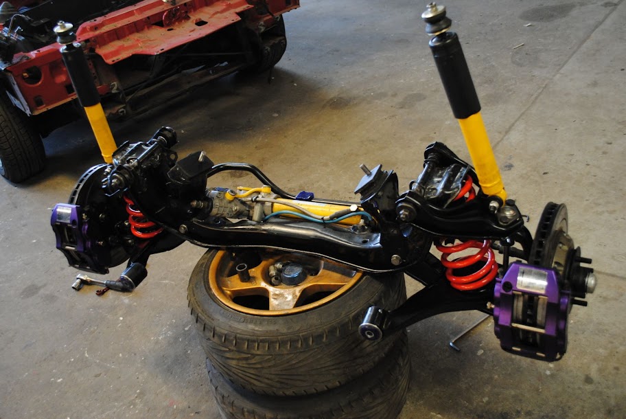

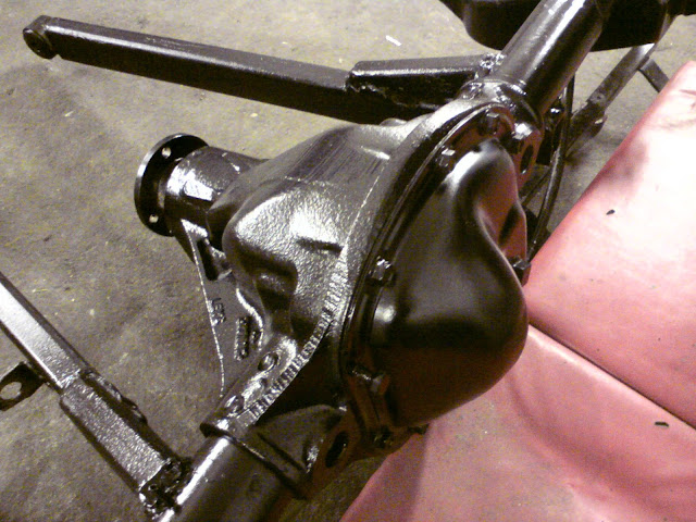

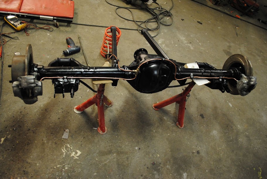

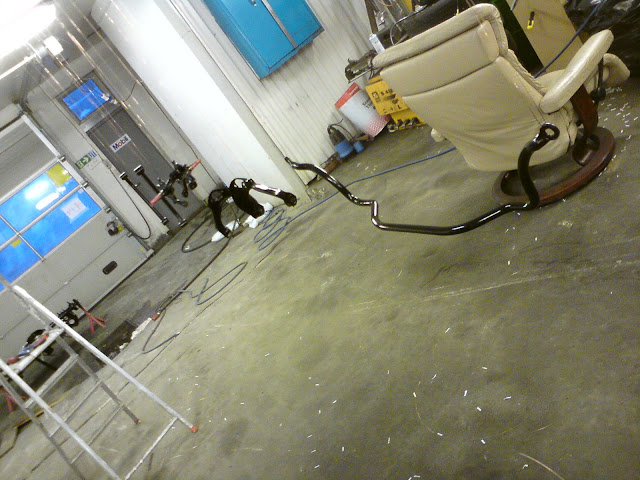

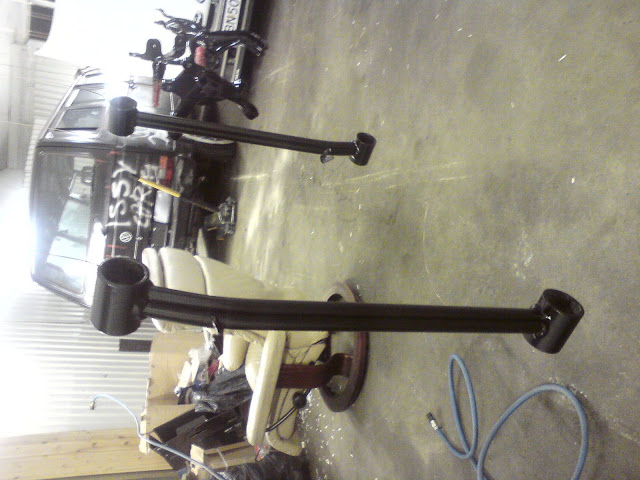

    Som new fotos from todays work
    Front axel finished
    And som of the rear axel

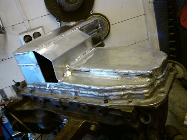

    Som pictures from todays work...
    Allmost finished with the BIGGER sump then last year
    This was last year model,

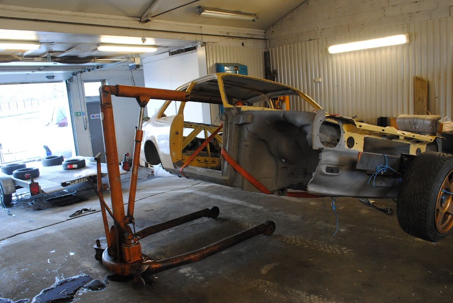

    is There a photo adapter plate for getrag 265 with with Manta 1800 clutch-house? What will be cardan shaft?
    Power Steering from Е30? Or what from?
  26. #50
    Dec 2008
    Grimstad Norway
    89
    76 Kadett C - 402whp
    Re: Kadett C 16v Turbo
    Very interesting project!
    Power Steering from Е30? Or what from?[/quote]

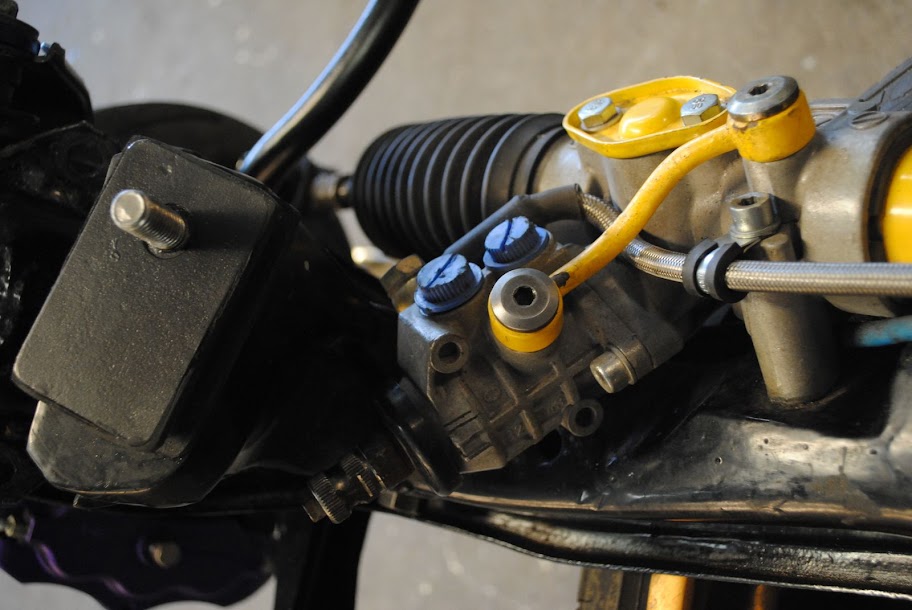

    Here is som pictures of the adapter plate...
    The power steering is from www.sellholm.se (swedish rally shop)
    originally it is a short power steering to the Volvo 240 that ZF has created.
    With 2.2 laps on the steering wheel from side to side
    Here is some updates at the same time =)

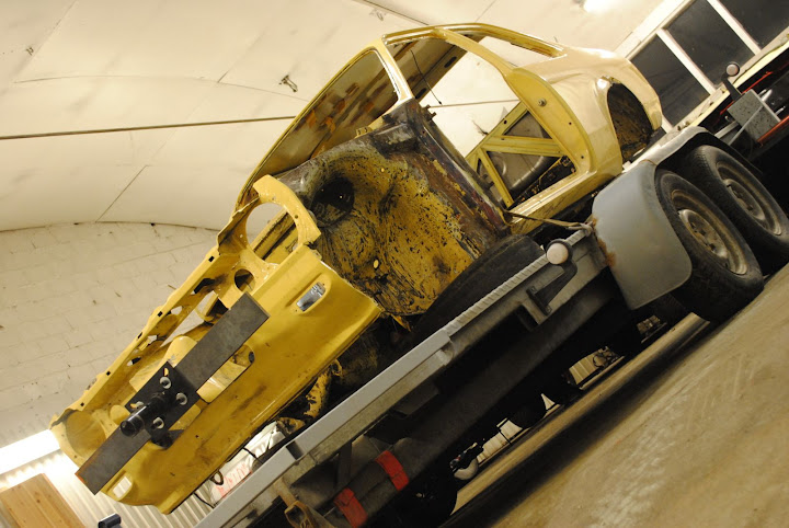

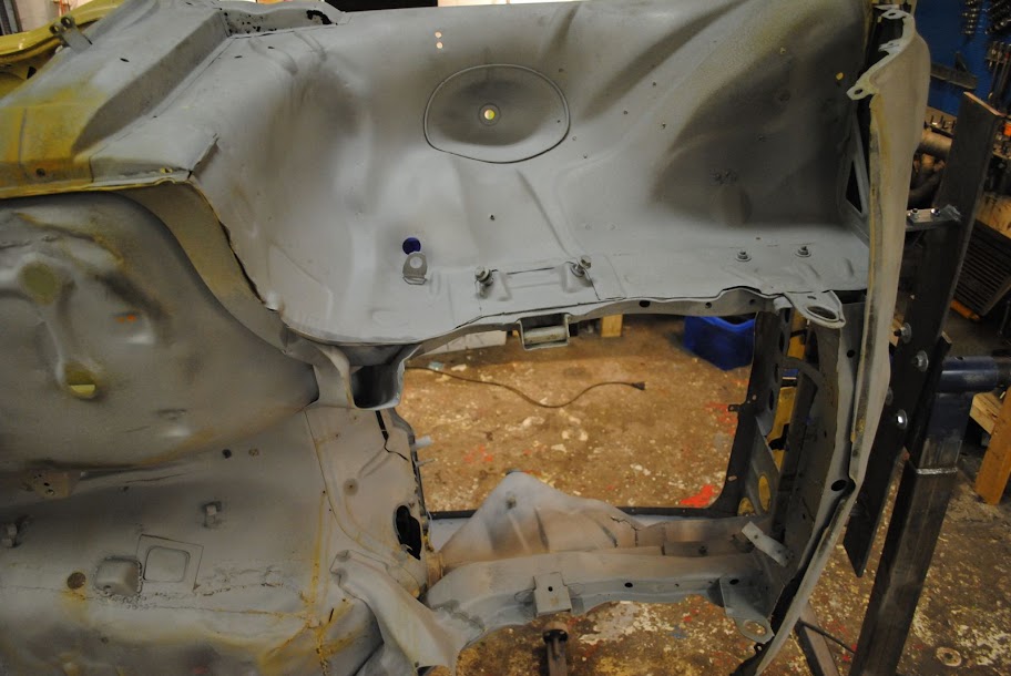

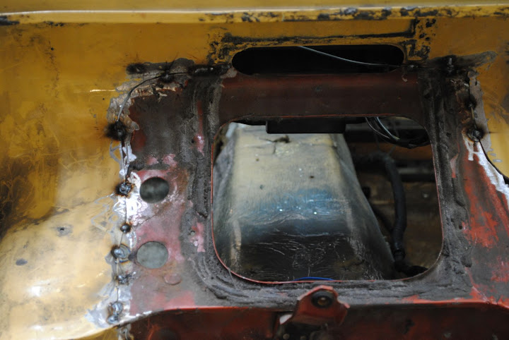

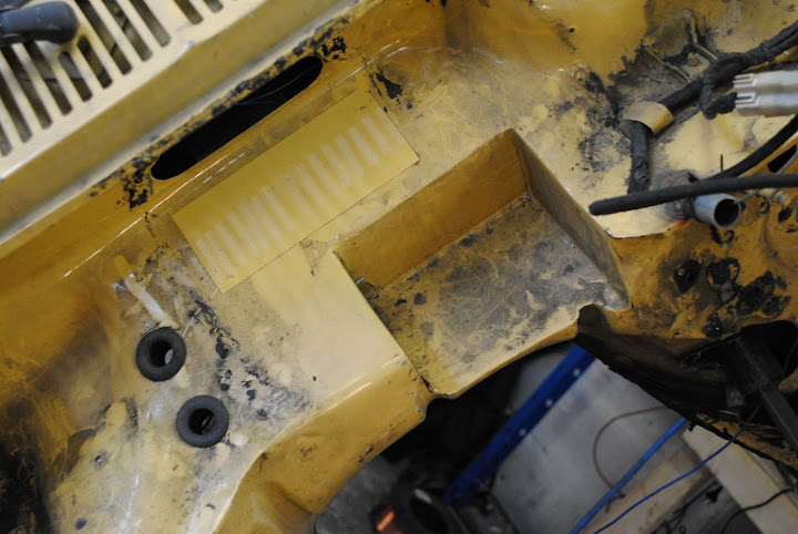

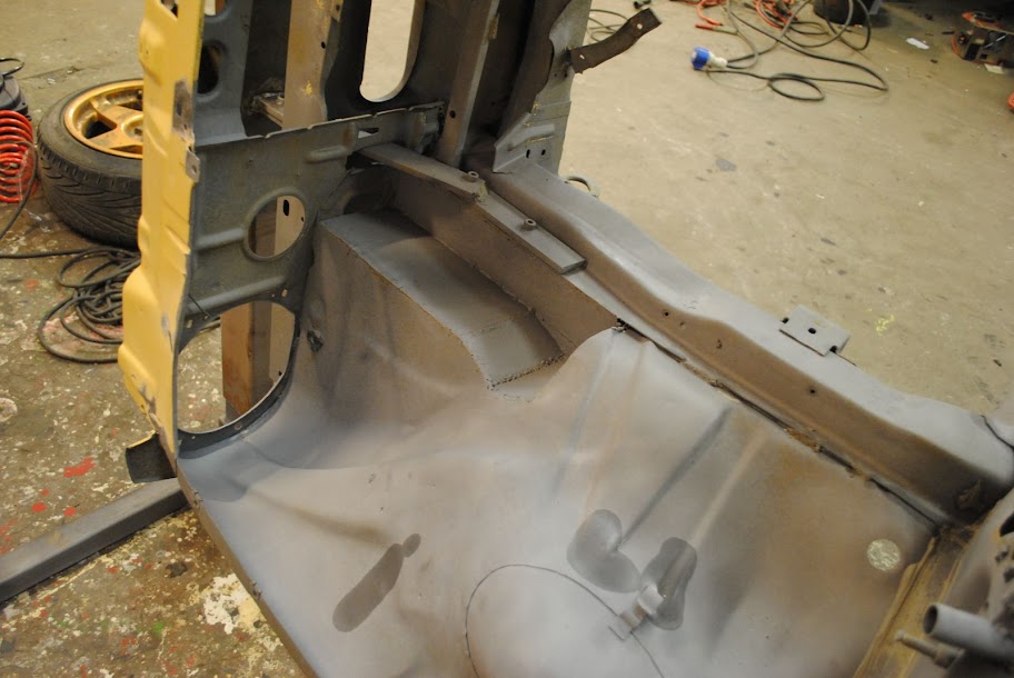

    I've welded into the original heater again, after having taken it away to make space to the orginal motronic injection.
    I bought a new work car, as the old one died (omega A )

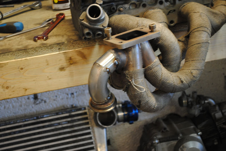

    New modefied, powder coatet "head cover" without the flange on the top
    Moving the wastegate to make som space to the new BIG aluminium radiator.
    On the way to sandplasting
    Sandplasting finished
