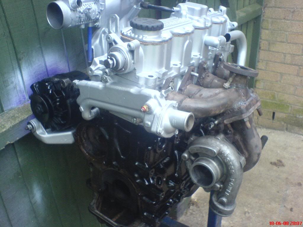

here is the car i picked up for £50 didnt get the wheels lo
this is the engine i took out of it
IMG]http://i190.photobucket.com/albums/z281/michaelwardtsk/DSC07318.jpg[/IMG]
IMG]http://i190.photobucket.com/albums/z281/michaelwardtsk/DSC07317.jpg[/IMG]
i now own the only 1.8 8v turbo vectra B in the uk running 14 psi on megasquirt half the valves double the power

and this is what it come out of my old nova
this is what the engine was like when i first built it up
had trouble with gear box my clutch wouldnt fit the f17 that was in the car so i changed my f16 over to hydrolic but had some trouble the slave cylinder wouldnt fit over the imput shaft so got a mate to grind it down for me hears some pics

thourt all was good got all the problems that i had out the way i was wrong when my mate made my maniflod it was going in to a cav so the mount was a lot smaller than the 16v vecky one so had some major grinding to do even took the grinder to the turbo

iTrader: (56)
Posts: 5,963
Re: my vectra 8v turbo build
That turbo is gonna be useless, looks like you got metal fillings in there!

Posts: 2,642
Not ideal by a long shot, you'll have to rethink that one IMO. Bargain Veccy though!

Posts: 7,705
i hope thats an old turbo just for mockup purposes!?!

Posts: 793
no thats the turbo thats going on it lol going to be getting a new one in a few months but useing it for a while

Posts: 5,963
I'd be very carefull then, as the swarf will be entering your engine!

Posts: 793
yer im a bit worred about that ive got to build something around it so that i can stick a filter to it

Posts: 2,642
How can you possibley fit a filter on it now you've cut it off at the housing?

Posts: 793
turbo is off now will be cleaning it tomorrow as for filter going to build a box around it and make that so that a filter can fit on to that so stop things getting in there

Posts: 6,500
wheres the AFM going??
do the shafts even fit the F16 as it was small block before?
did you machine the back of the slave cylinder? they pop the cover off the back if they havent located properly and piss brake fluid everywhere.

Posts: 793
im useing vecky v6 shaft on it still got them to fit
dont need a AFM as running stand alone managment
yes the back of the cylinder has been flushed hopefully it works i hope so

Posts: 2,194
Is it me or is there less than a few mm holdin that mount to the block?????
Is that a Nortech manifold?
One of the biggest bodges of all time?
What power is that baby pushin out?

Posts: 793
no it has 4 bolts holding it on 2 at top two at bottom lol the manifold is one that my mate made up for me up for your right it is one of the biggest bodges ive done and trust me ive done loads lol power wize not a clue going to get it rooling roaded soon

Posts: 362
get some steel plate and make a new mount! that one will likely snap under the torque! Somthing similar to nova xe conversion mount should do it, or even mod one of them....... good stuff tho, i love home brewed nonsense like this!

Posts: 793
lol thats what im going to do when every thing is all done and sorted as defo got to sort it just in case it does snap just bodging things at the moment to get it all in and running then going to go over every thing and sort it all out

Posts: 27
nice work , something different for a change , not sure if that mount will withstand full boost much now its ground back , re-making it in steel , to clear the manifold could be an idea , get the henry hover on that inlet in a rush !!!!!! ,
