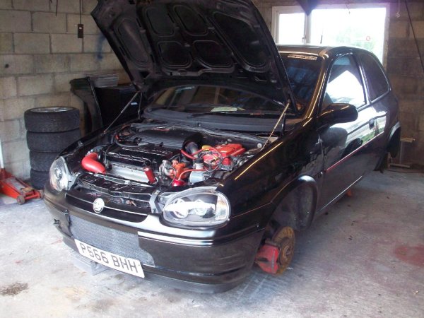

Signed upto Migweb not too long ago and just become a fully paid member so thought I might aswell put a project thread up, Ive had 6 Corsa's currently own 2 still, my daily run about which is my Green one which some of you may have already seen on Corsasport
And then my latest project, purchased off mig member flopstocks for £2400 in May of this year.
A few reicepts aswell
First prioritories where to get it running perfectly and mechanically sound

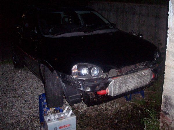

So up it went on axel stands to make sure the underneath was perfect, I know what older Corsa shells can be like so it had to be done
Its a very clean shell, only found one rust hole in the rear arch so it was welded up straight away along with a fresh coat of waxoyl
Next was new rear brake discs, pads and wheel bearings
Car was ready to go back on the floor for abit, problem being I had 4 alloys with knackered tyres, so I thought i would treat it to a new set of wheels

All was fine until the other day when driving it around town and one of the oil cooler pipes burst, all due to it digging into a jubilee clip, oil warning light came on and started tapping to hell so rolled it home
After getting it back up in the air we found the pipe and got it off.
So just awaiting some genuine Vauxhall 10w/40 Semi-syn oil and oil filter, and got to track down a new pipe, just in time for MOT Fingers crossed it passes but Im sure it will fail on something
Got along way to go with this project, just making sure its mechanically sound before i go any further with it, but next step is decent suspension, better brakes and then onto exterior and interior, have tons of plans but keeping them secret for now, so plenty of updates on the way.
Cheers
