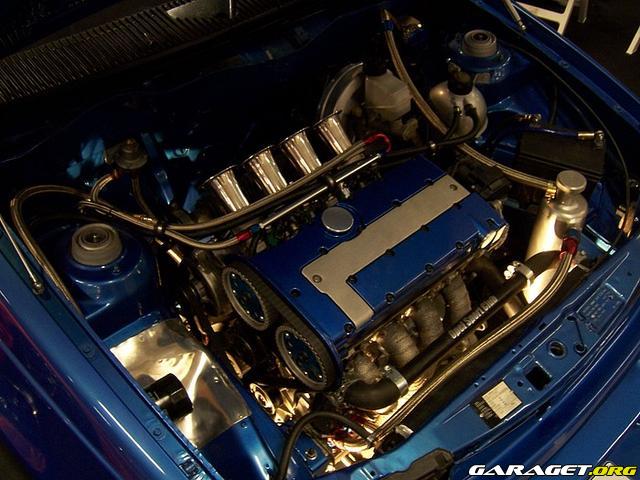

2007 engine:
2.1l std valves, 13:1 kompression, 8500rpm, 260hp at the flywheel 248nm
Head
Coscast head, race spec.
Inlet cam 11.95lift 310g dur
Exhaust 11.90lift 300g dur
33/29mm race valves with wasted stem
mec lifters
titanium retainers
kentcams double valvesprings
Cat cams cam pulleys
ported polished and flowed by Erland Cox www.topplocksverkstan.se
bronze guides
bottom end
88mm Omega high komp pistons
SPM steel conrods with arp bolts
knife edged and balanced crankshaft
viktat o balancerat vevparti
engine race bearings
ARP bolts all over the engine
Pace drysump kit
Inlet manifold and management
tapared Jenvey 45mm ITB with 90mm airhorns
bosch 465cc injectors
malpassi fuel pressure regulator
bosch 044 fuelpump
MBE 967i ecu
sbd coilpack
multivee 58teeth pulley
angeled cranksensor
exhaust system
4-1 3step
primarys::
200*38,5mm
200*40,5mm
200*44,5mm
mergekollector (4-1) with megaphone from 63,5mm to 80mm
gearbox:
Quaife 5sp syncromech kit 4.50 final gear
Rallycross LSD
homemade shortshifter
calibra driveshafts
harry hockley release bearing
3,2kg steel flywheel with 0,5kg ringgear
184mm super clutch twinplate

pic of 2007 engine
