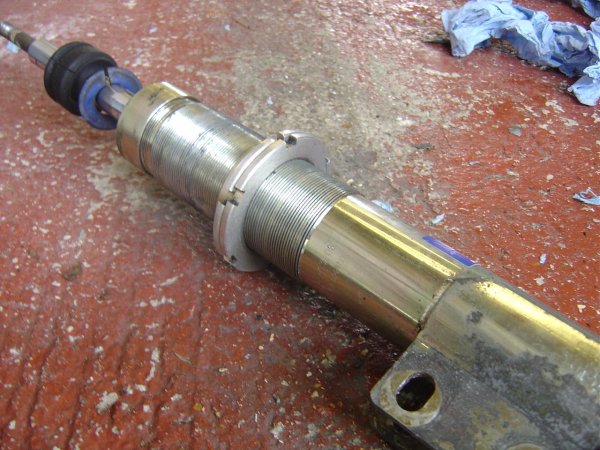

Originally Posted by Lawrence* View Post
There not the wheels i'm using, they came straight off a cav and have some stupid width/aspect ratio on them, but I will keep a eye on that!!!
you might find they will rub anyway,
i had to remove the helper spring on mine...

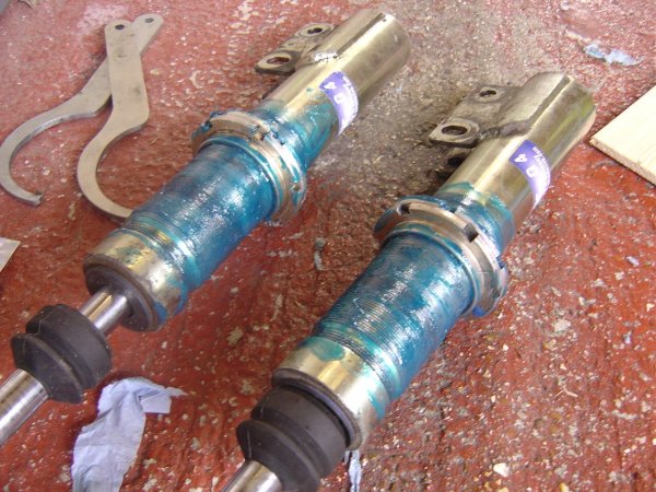

are the top bolts, where it bolts to the hub not camber ajustable? so you can lean the wheels toward's the arch abit more to clear the coilover...
im sure vegasphil had the problem with the tyre making contact and changed with that..
No, not unless you buy camber bolts or elongate the holes!

well looking at the suspension... bottom hole is normal, top on its like a long oval...
would of though, it would change the angle of the wheel slightly, if it can slide forwards and back on the top hole :s
can also see it on this hole

Posts: 19,780
Not to anyworthwhile degree mate, why do you think people buy the bolts when they lower them? You will only have an absolute flee's penis to play with, it would be so minimal it's not worth bothering!
The tops of the hub are not oval as standard, if yours are then someone has opened them out mate.

there not mine, im sure they was like that when he got them :S
it helped clear the bottom adjuster though
