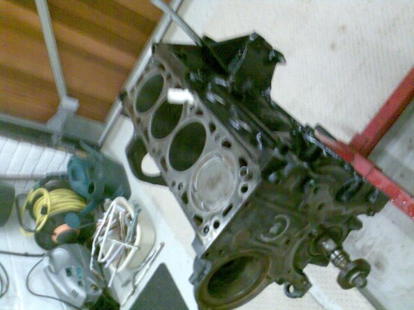

Old 18-02-2007, 21:56   #8
Join Date: Jan 2006
Location: Maidstone, Kent
iTrader: (5)
Posts: 423
thats okay
weekends work
sexy a!
head + inlet out lined up to gasket size ready for porting
cylinder head half done - thanks dad!!!
now got to buy some more bits for the dremal! all worn out :lol:
all valves cleaned - almost to a polished finish, bit more work to do
once all head works done, i can regrind valves in, and start building up
