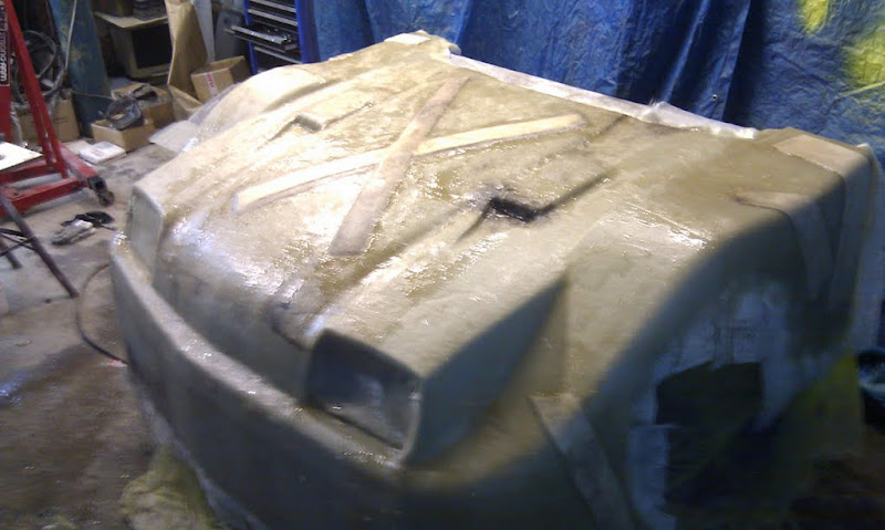

    Stupid question, but the vents and lights look like the mould will have to be released forwards. With the Naca style vent depressions, will the mould actually release?
    Life is not a journey to the grave with the intention of arriving safely in a pretty and well-preserved body, but rather to skid in sideways, thoroughly used, totally worn out and loudly proclaiming... "f*ck, what a trip!"
  9. #8008
    Feb 2003
    ruislip
    18,226
    nova 1.8 16v on tbs
    Re: Lee's Garage
    it should pop forwards and off i reckon, the vents will be the sticking point, but if it goes forwards and up it should be fine, soon find out anyway!

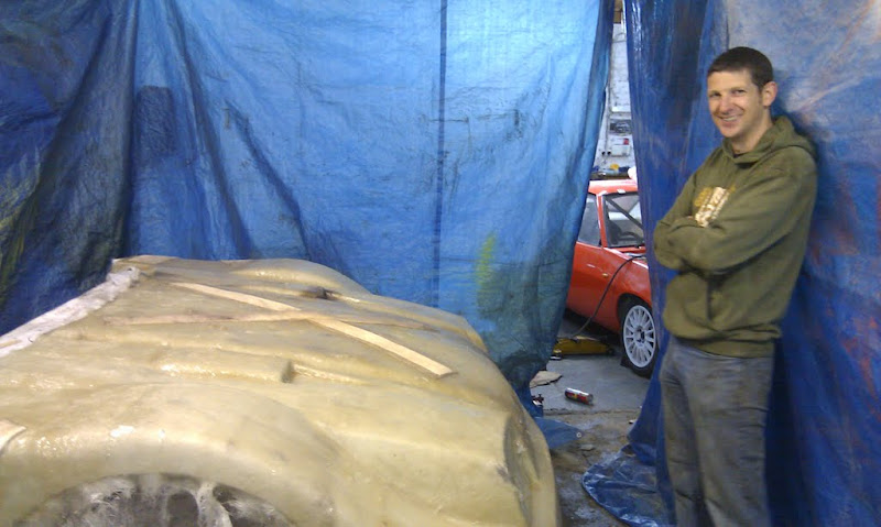

    Anyway, finished for today. Have run out of energy and resin :-)
    Added some strengthening and a layer of thinner CSM.
    It's not going to win any beauty awards, but the important bit is the inside.
    Brian made it too, his wiring loom is looking much better.
    Am back on monday, hopefully with more fibreglass. The plan is to release it on monday :-/ and then add any extra strength to the mould, plus make a stand for it for laying up purposes.

    personally Id leave it longer than Monday mate, might still be a bit green by then tbh.

    Lol, I reckon it'll be ok by next week, only a few layers afterall, but if you can wait till next weekend you might as well, not like its the cars last component!

    Just done a massive fibreglass order, will be with me on Tuesday. Will be enough to make a few panels, moulds and plugs.
    Lets see what state it's in on Monday. Am not in a rush though, there's plenty to get on with. The MR2 needs a clutch for a start, then there's a diff carrier, engine mounts, transmission tunnel, back axle etc to make.

    Mould is off in one piece :-)
    looks amazing, it's come out really well for a first ever moulding effort! Brian has the photos... :-D

    Photos as requested:
    Original, still in primer:
    Painted up:
    Released from the mold (Which was remarkably easy for the size of the thing - just goes to show how well prepped it was! ;-) ):
    The plug is in more than good enough condition to be re-used, there were only a few tiny spots of gel coat sticking and one small bit of damage, but then it's a use-once thing anyway! lol
    ...and then the obligatory getting excited and sticking it on a *nearly* finished car! lmao
    Adds a bit more width, but I think my wheels fill the arches nicely! lmao congrats to Animal and this thing has come out really well. For a first ever molding project, it was pretty ambitious, but it's come out absolutely fine!
